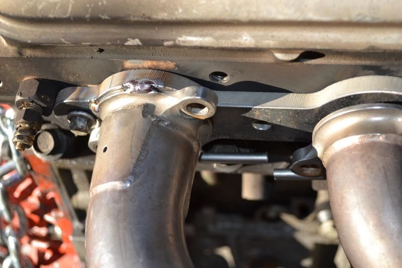

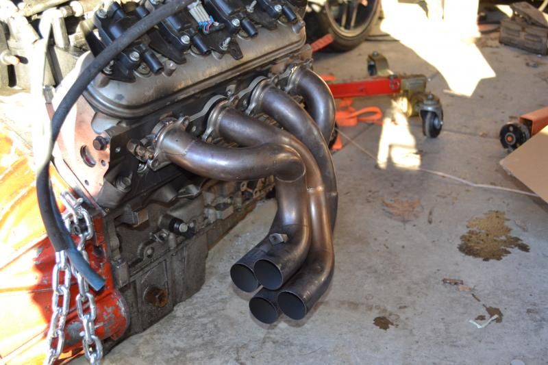

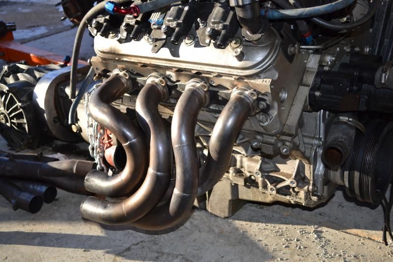

Ever since the turbo install, the exhaust on the track monster has been lacking to say the least. I decided to make some major upgrades for the 2014 season. I started with a used set of "NASCAR" headers off eBay. It turns out the port spacing on the Ford NASCAR engines is the same as the Chevy LS engines. The headers are a 4-2-1 design. Based on the initial mockup, I'm not sure if I will be able to keep the 4-2-1 design or if I will have to swap that out for a standard 4-1 collector. The pipes are long and wide, and I believe they will hit the chassis. I am going to put the mockup engine I have in the chassis for fitup. Below, you can see some pictures of the right side primaries bolted to the engine. While the port spacing is the same, I did have to change the flange. I decided to simply weld a mild steel 3/8" flange to the cast SS flanges on the primaries. That meant I didn't have to hack up the nice reinforcements on the primaries and the cast flanges make for a great weld joint.

I ordered the collectors last night after trial fitting the headers in the car. The original 4-2-1 collectors are too long and hit the chassis. These new collectors will be a standard 4-1 slip on collector. They should be here in a few days.
